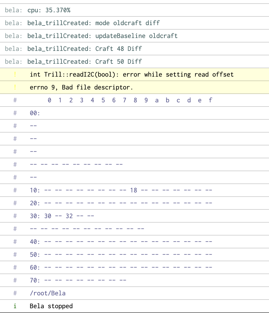

      this is what i have when i type "i2cdetect -y -r 1"
      what does it mean? how can i fix that error?
      Do you get any confirmation about creating bar on 0x18? That may be the one causing the issue

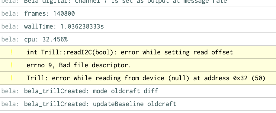

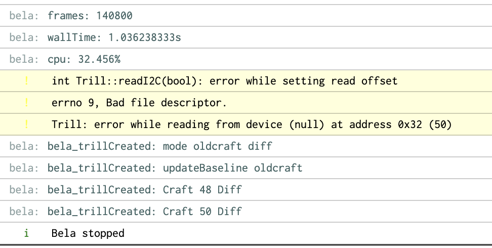

      I have a patch where i just test the trill sensores everything works fine. But when i have them in the main game patch gives this error:
      The three of the trill sensors seam to bave been created although it gives that error. Do you think it has to do with the CPU some how?
      I removed the "--board Batch --codec-mode=s=1,p=95,t=1" and now it works.
