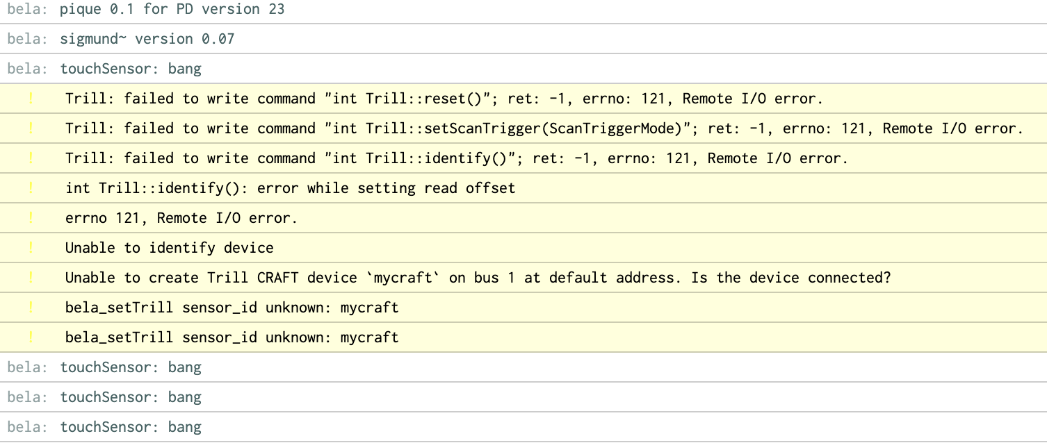

    I have one new trill craft sensor and the old one. The new one works perfectly fine but The old one doesnt seam to work and i belive its because of old frameware.
    I have the following error
    and this is the old craft sensor im talking about
    I have the wires soldered and i have tryed pullup resistors as well.
    So i just want to confirm if the problem is on the firmare or on something else.?? I also want to confirm if i can use both the new and the old sensor working together in the same I2C bus or not. Just to know if i should order a new one.
    Thank you
    those old sensors may have 0x18 as the address instead of the 0x30 of the new ones. Try to specify the address manually when intialising the sensor. Something like
    [new oldcraft 1 CRAFT 24(
    (24 is 0x18)
    great, it works!
    Side note, apparently the old craft is considered as BAR by default so i had to change the mode afterwards to work as DIFF mode like the new craft board.
