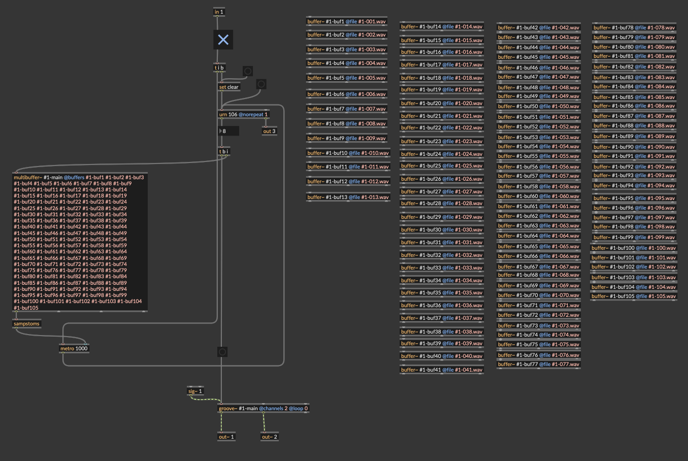

In RNBO, I use a very simple patch (screenshot below), to select the files read by a groove~ which buffer is changed by a multibuffer~. I declare all my audio files with buffer~ objects, they seem to be recognized in the console of the IDE. It seems it’s the working method right now in RNBO to use buffers, even though it’s really painful to name individual files like this.
So my question is, what could be the reason for not supporting this amount of audio files ? And what could I do to make it work ? It seems the RNBO part is working, but it might not be the best way to do that when using Bela.
