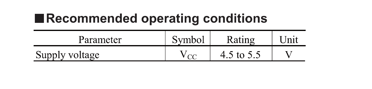

The datasheet says the supply voltage should be between 4.5V and 5.5V:
So you have to use 5V.

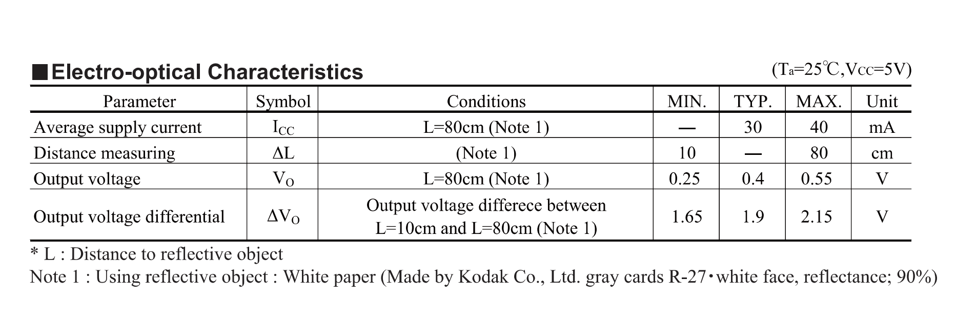

It also says the distance range is 10 cm to 80 cm

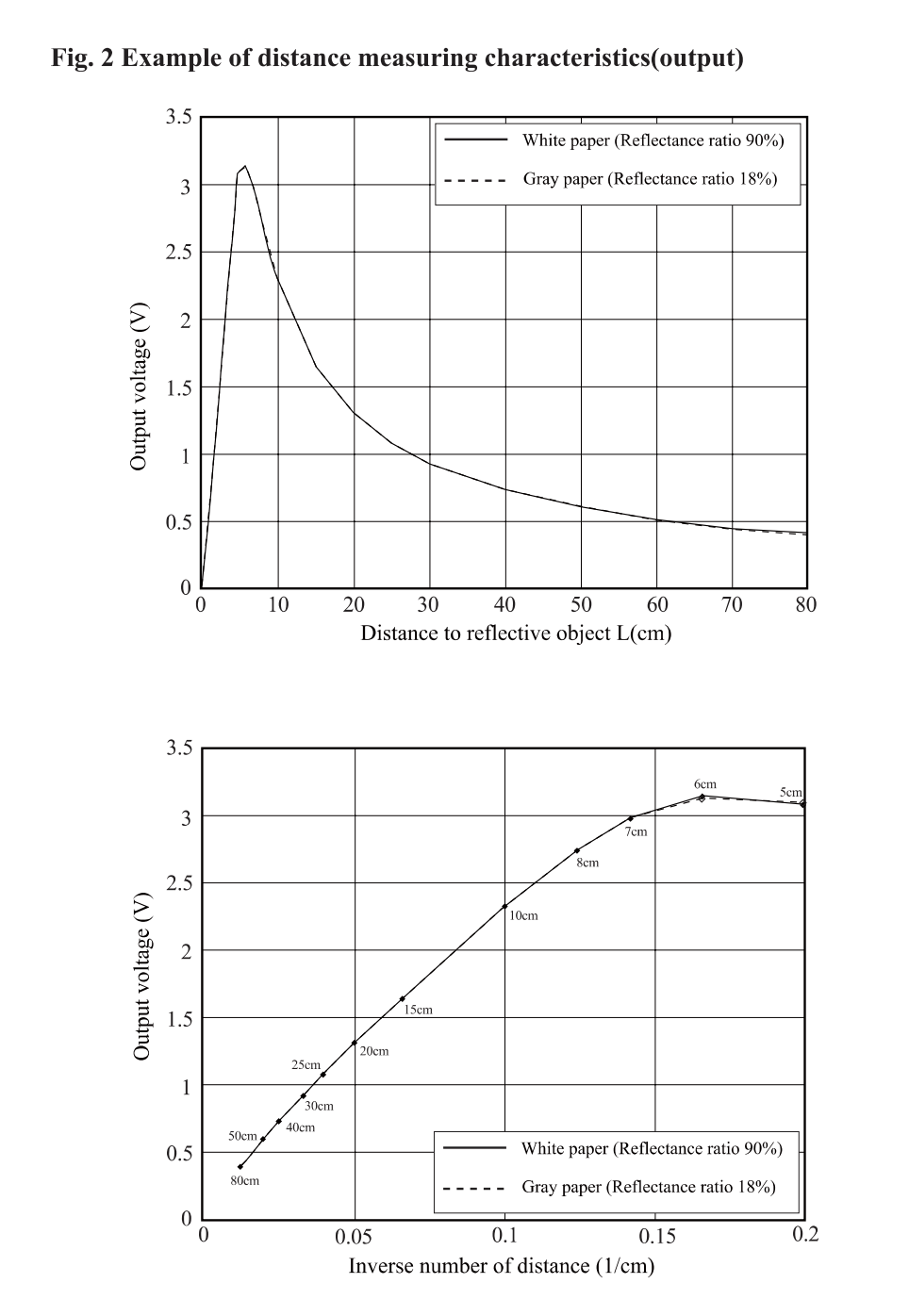

It then shows that it also works at shorter distance, though, as expected, it's non-monotonic:
Not sure what you mean by "negative values". If you are trying to measure distances in the 2cm range, this is probably the wrong sensor.
