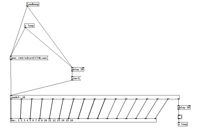

I've purchased a CTAG Beast for the simple task of playing a 16-channel audio file (around 10 minutes long) in an endless loop for an embedded audio installation. I'm using PureData to program the board, here's a screenshot of the patch:

The last time it happened, audio playback resumed, but 99% of the time it stops all audio coming out of the board, and I have to recompile in order to make it run again. I've tried changing the block size, but it hasn't solved it. CPU usage is around 30%. The file is a 16-channel 44.1kHz 16-bit WAV file.
I'm waiting for a new SD card today which will be a SanDisk Extreme Pro, but the card that's been in there so far has worked well for me in a camera before.
What could be the cause of this behaviour? Am I doing something wrong on the PD side, or is there a problem with the way I'm configuring the Bela? The installation is due new week so I'm kind of in a tricky situation.
