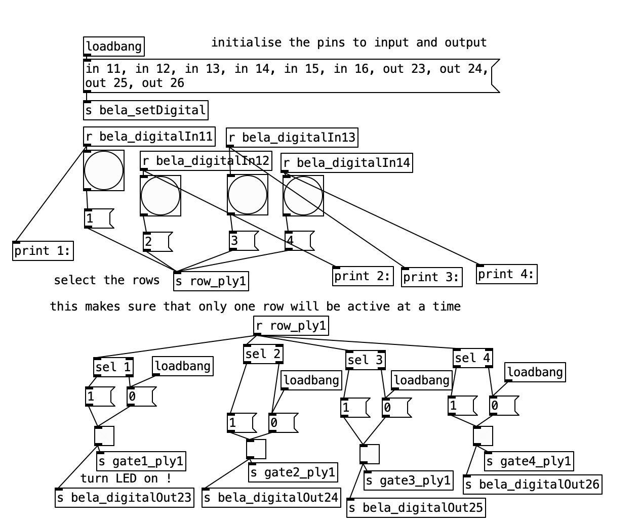

When testing just the buttons and LED with a simple main.pd it works fine.

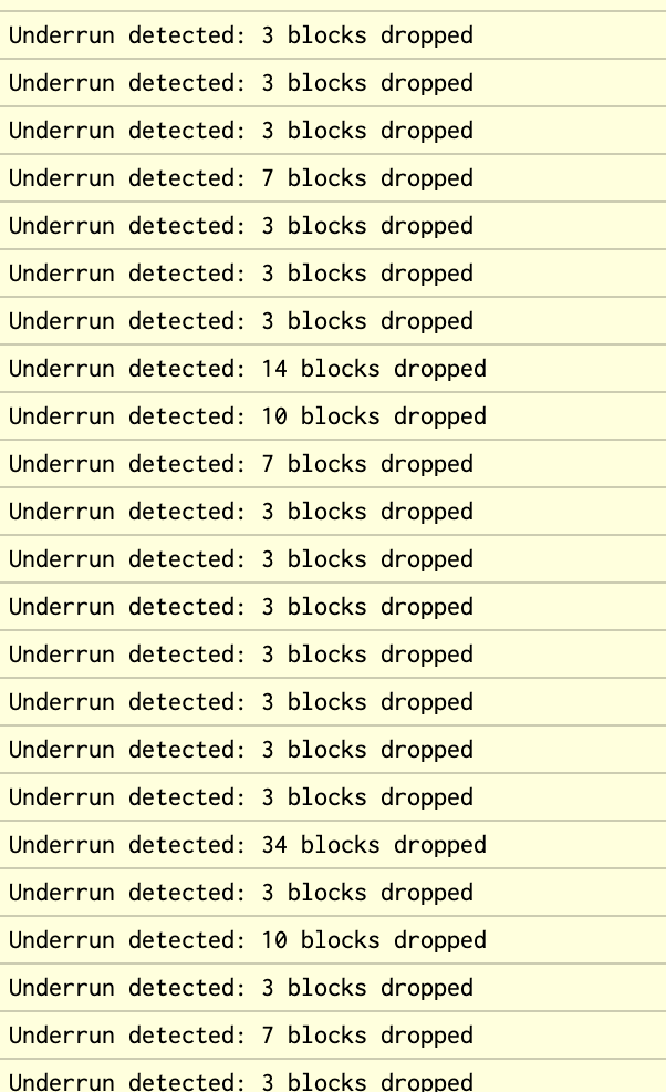

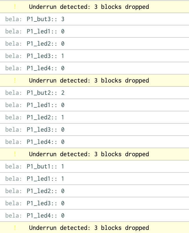

But when I had this same code to the main project I'm doing, sometimes the LEDs start glitching and the sounds as well. What I believe its happening is that the buttons enter this loop state and a possible fix I've done in Arduino before is using this software interrupts

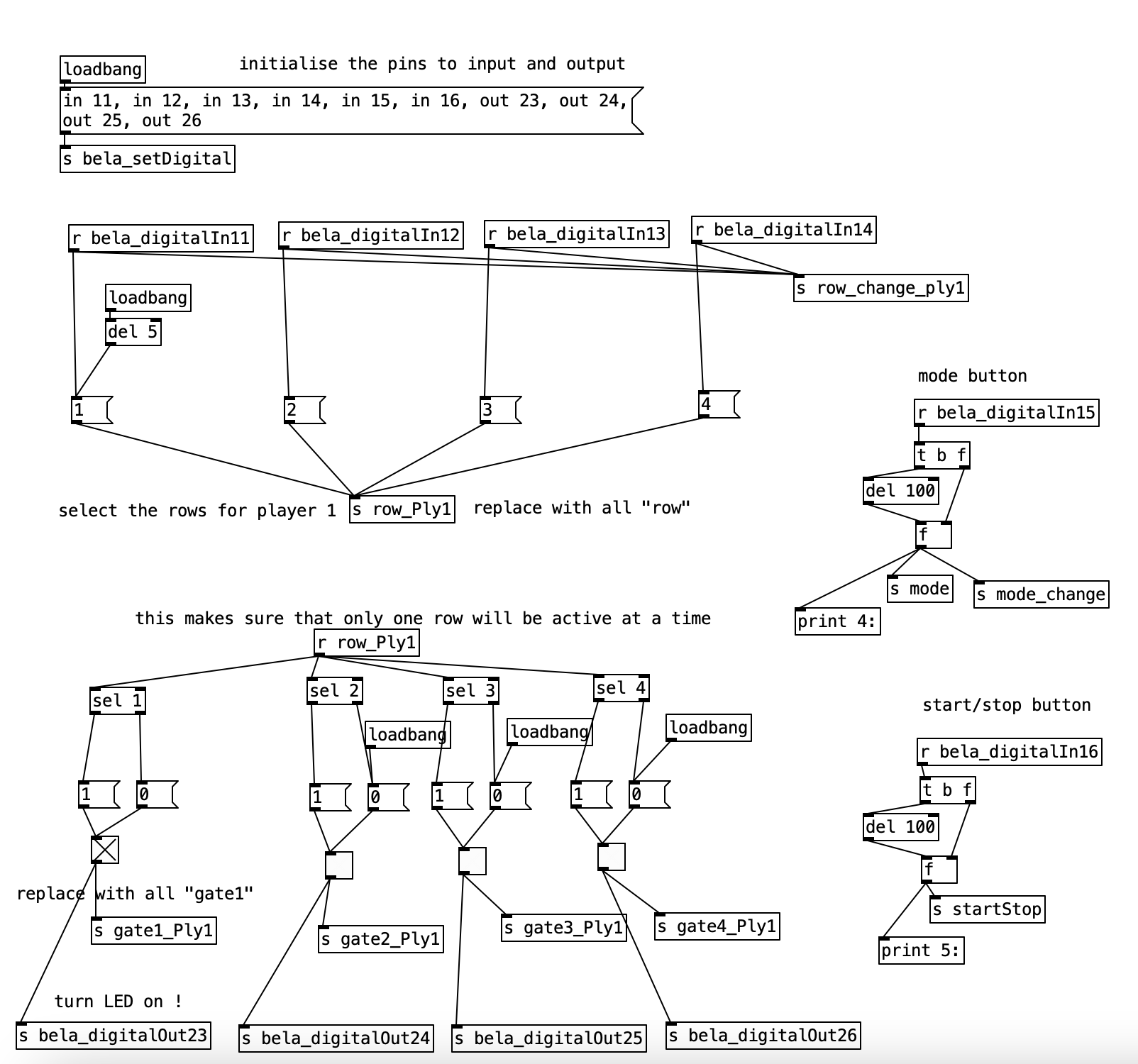

Also, this is how I do in the main.pd of the big project
It doesn't seam an Hardware problem as the setup is fine and works on the simple code so I believe the fix has to be software. As I'm still new in Pd and Bela, I was wondering if you could help me out with this.
