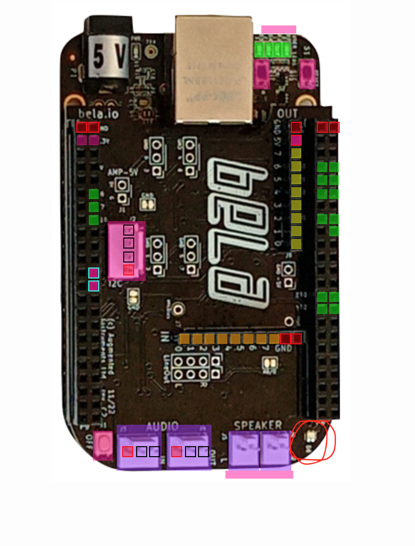

When a patch (pd) is running on the bela, the D6 LED flashes, this one:
When running the bela as a standalone, and having built it into a box, is it possible to assign this LED to a digital output through pd?
In order to give the user a visual ping that the bela is booted and ready?
LED D6
The signal for that LED is available on P8.38, so if its blinking pattern is fine for you, you could just wire that up to an LED on the outside of your box. Would that work?
