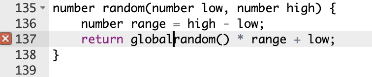

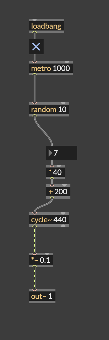

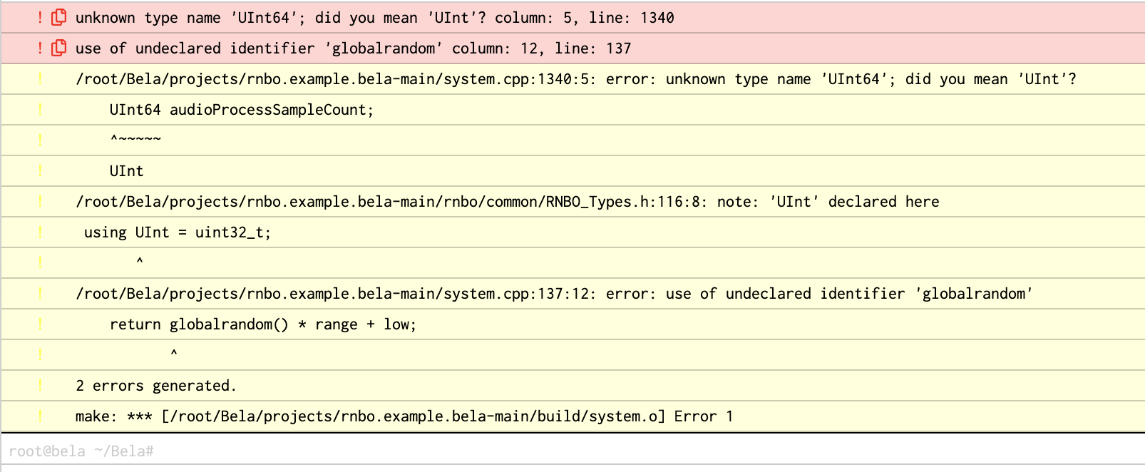

I'm trying out the RNBO to C++ integration to Bela but there seems to be an error when using the random object? Is there an easy fix for implementing randomness in a RNBO patch that can be used on Bela?
Can you share the rnbo-generated C++ code please?
    thanks. I updated the code on the main branch of rnbo.example.bela. Download it afresh and try again.
