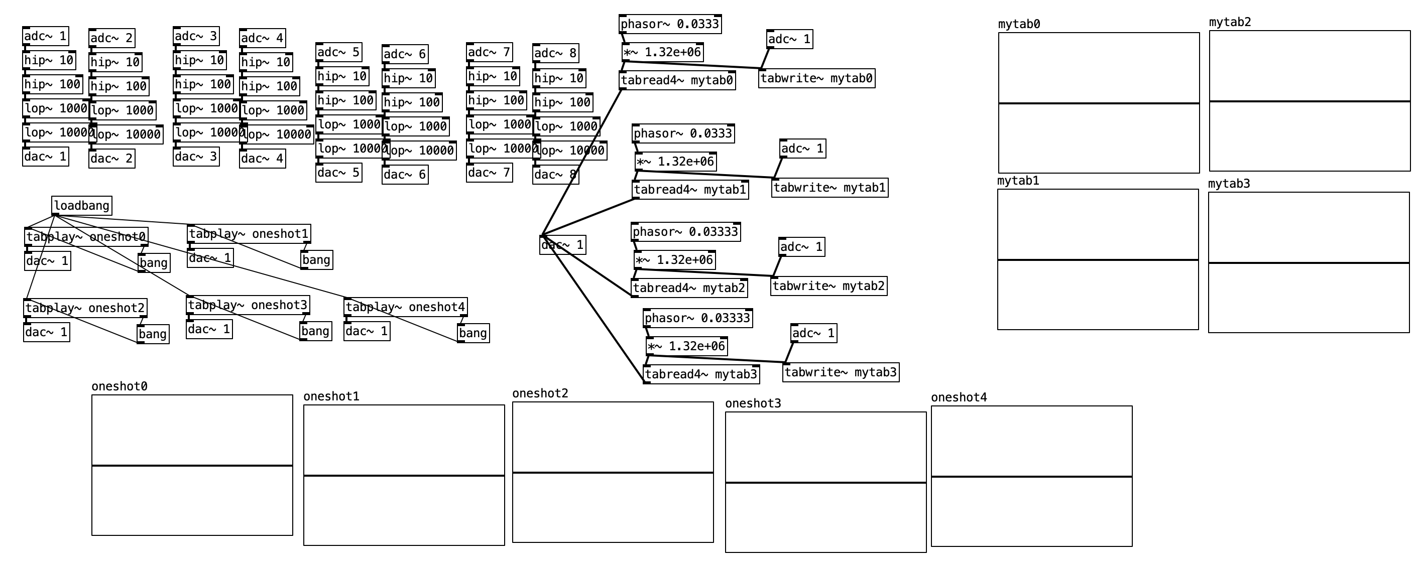

Hi all! im working on a project right now that im pretty sure the bela mini multichannel will be perfect for, but im a little concerned about processing power.
I will be using it to run a pure data patch consisting of an 8 in, 8 out audio mixer, with 3 band eq per channel (using 2 lop and 2 hip objects per channel), plus a 4 channel looper (using 4 30 second long tables and tabread/tabwrite) and 5 oneshot drum sample playbacks (using tabread).
I know its hard to tell without running the actual patch, but does this sound like its within the belas capabilities? A block size of 64 would be fine but id rather not go below 44.1khz. I just dont want to spend £180 on something that doesn't end up having enough power to do the specific thing im buying it for, and I have a feeling ill be asking too much of it.
Any insight would be welcome!
So we are talking something like this but with controls?
_main.pd
5kB
This runs with about 31% CPU on Bela Mini. It will be a handful percent more on the multichannel version, but it seems you are very well within the capabilities.

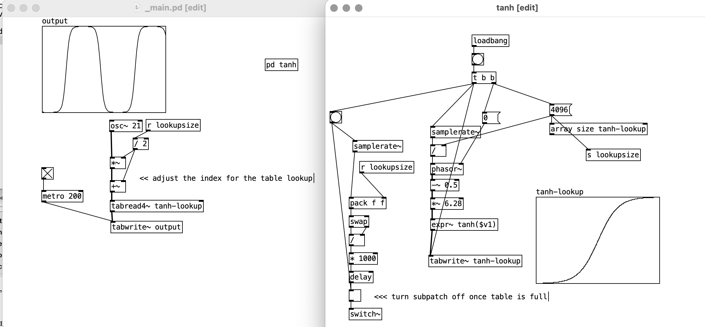

      expr~ is always expensive because of how it's implemented and an accurate tanhf() called at audio rate is expensive. You can achieve pretty similar results with a table lookup: populate a single lookup table with a tanh and then use [tabread4~] to read through it for cheap any time you need it .
      • fen replied to this.
        giuliomoro oh interesting! I'm using them for a post-gain soft clipping limiter on the inputs right now so they're pretty much constantly used, but I can live without them if it's the difference between being able to run it or not.
        When doing table lookup it's just the cost of one additional tabread4~ each, so not much at all.
          • Edited
          giuliomoro ohh that makes sense! I'll definitely look into implementing that! I'm not super clear on how I'm process my audio through it though? Do you have an example?
          Oh wait I get it, its just a case of plugging the audio into the table.and getting it modified by the function out! Genius
          something like this. The table gets populated at startup using expr~'s tanh, then the subpatch is switched off so expr~ stops consuming CPU (alternatively, you could do it once on the host and then save the array content). To read from the lookup table you need to resize your audio signal from -1 to 1 to the length of the lookup table.
