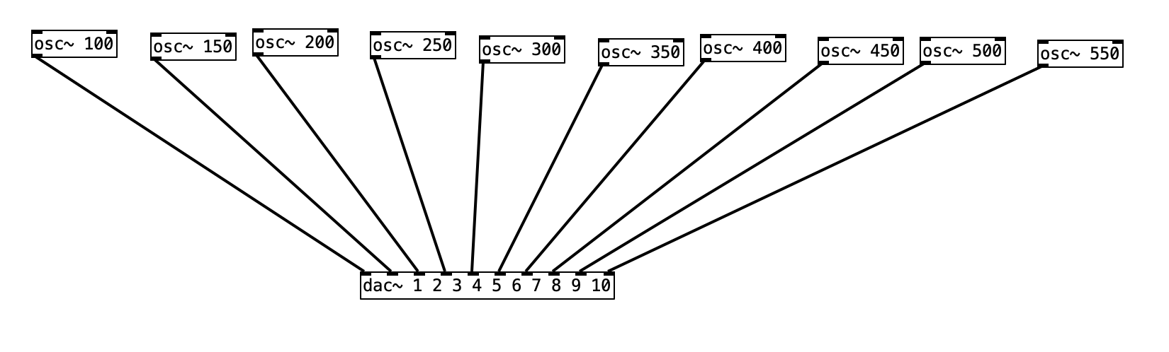

Create a new Pd project and use this patch, does it work?
main.pd
527B
Okay, thanks, that worked! But I am still struggling with SuperCollider, I tried
