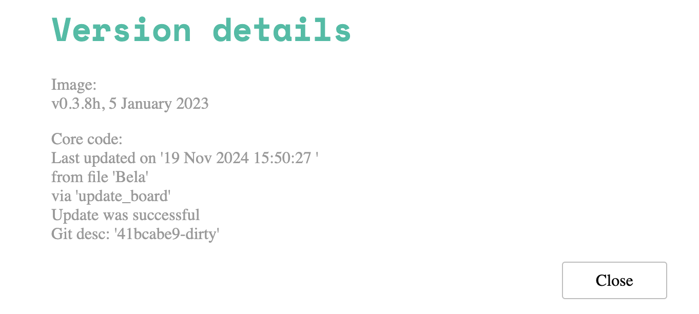

Version details v0.3.8g
I can't find PureData/uart-communication, where is it?
    John Version details v0.3.8g
    it should say much more than that, e.g.:
