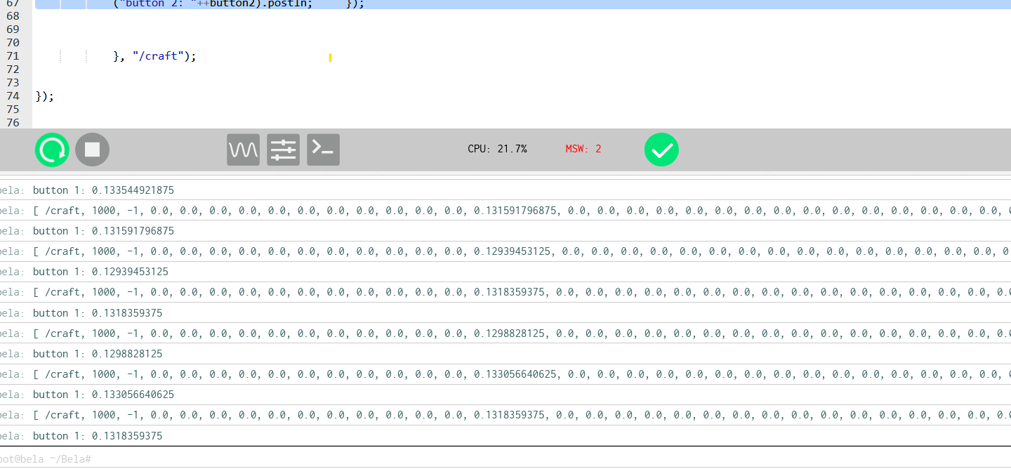

and then touch the first button that is connected to the Craft, I get good readings:

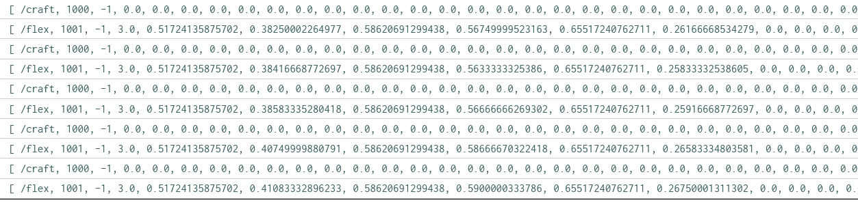

But as soon as I add my flex synth to the setup:
SynthDef(\trillflex, {|t_recalibrate=0.0 t_updateTrill=1.0|
var i2c_bus = 1;
var i2c_address = 0x48;
var noiseThreshold = 0.045; // float: 0-0.0625, with 0.0625 being the highest noise thresh
var prescalerOpt = 4; // int: 1-8 with 1 being the highest sensitivity
var touchsigs = DC.ar(0).dup(3); // use 3 touches
var centroids;
var rawvals;
var out, ping;
centroids = TrillCentroids.kr(i2c_bus, i2c_address, noiseThreshold, prescalerOpt, t_recalibrate);
SendReply.kr(Impulse.kr(10), "/flex", centroids);
}).store;
~trill_flex = Synth(\trillflex);

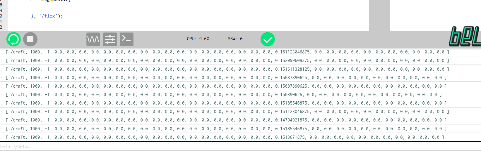

I just get zero readings from the TrillRaw / craft, while the TrillCentroids / flexes are working fine (all four of them). So somehow the TrillCentroids is blocking the TrillRaw. On my previous Bela mini (that unfortunately broke) I had a setup working in which TrillRaw's were working together with TrillCentroids, so I am suspecting some kind of build issue here.
