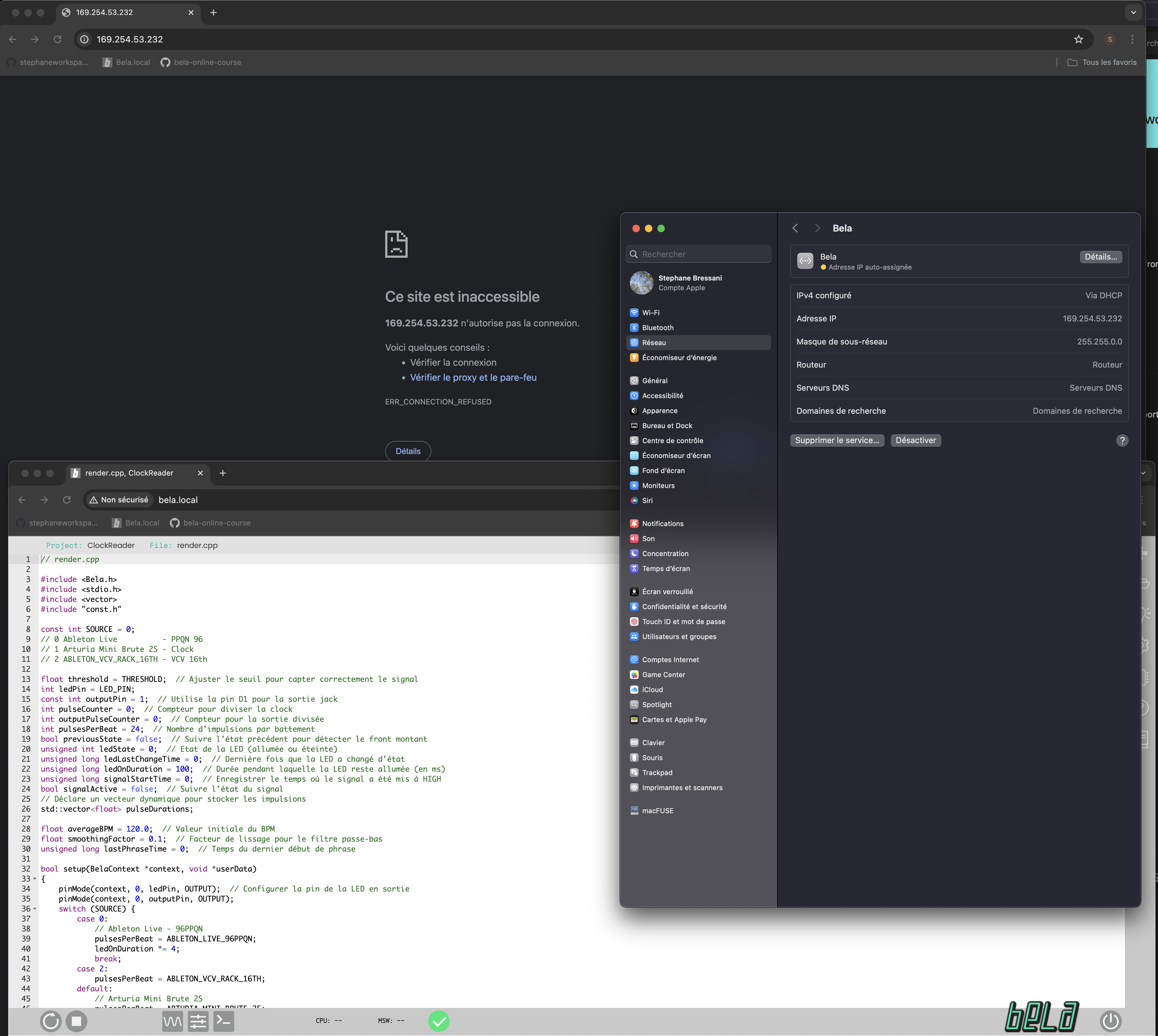

I never installed the driver, and I suppose the problem is here.
Everything is OK in the IDE, but only the scope doesn't work. I did exactly the same manipulation from lecture 0 on YouTube and the scope is still blank.
I tried to acces with IP and it was unsuccessful.
And for the driver on the sd card, macOs change something with macOs Sequoia, I can't install.

Can you check in your network settings if the Bela interface has an IP address?
There is an IP, but It doesn't open the IDE
I've tested with 192.168.7.2 and no success too
But I tried on a Linux computer and both scope and gui js are working
Looks like it's not picking up the IP address form Bela's DHCP server. Set "IPv4 configuration" to manual and set the Adresse IP to 192.168.7.1 (note .1 at the end) and then you should be able to reach the board at 192.168.7.2 (note the .2 at the end). The IDE, scope and GUI should all work then.
