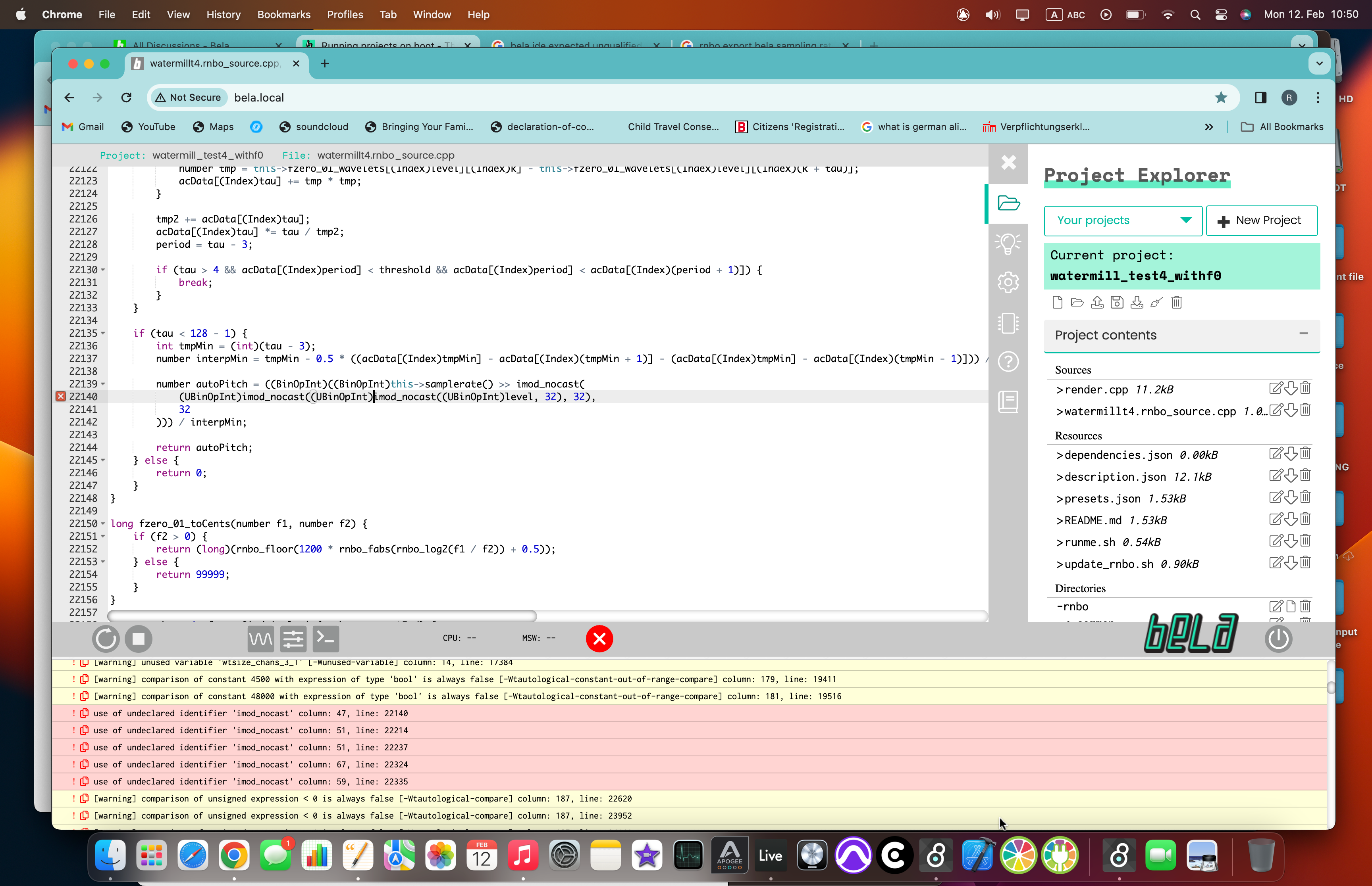

I am building my first Bela instrument through RNBO C++ export. I have the Pepper set but I have not soldered it yet. The Wavetablesynth session needs the frequency information converted by a RNBO's object called "fzero"
However, I found that the "fzero" object caused an 5 errors "use of undeclared identifier 'imod_nocast' column: 47, line: 22140". How I know this caused the errors because I have tried to export my entire programme just excluding it and that works without the same issue.
Could you please suggest me with a solution ? And suggesting me how to declare the identifier in the case of using fzero?
