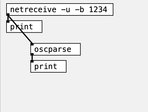

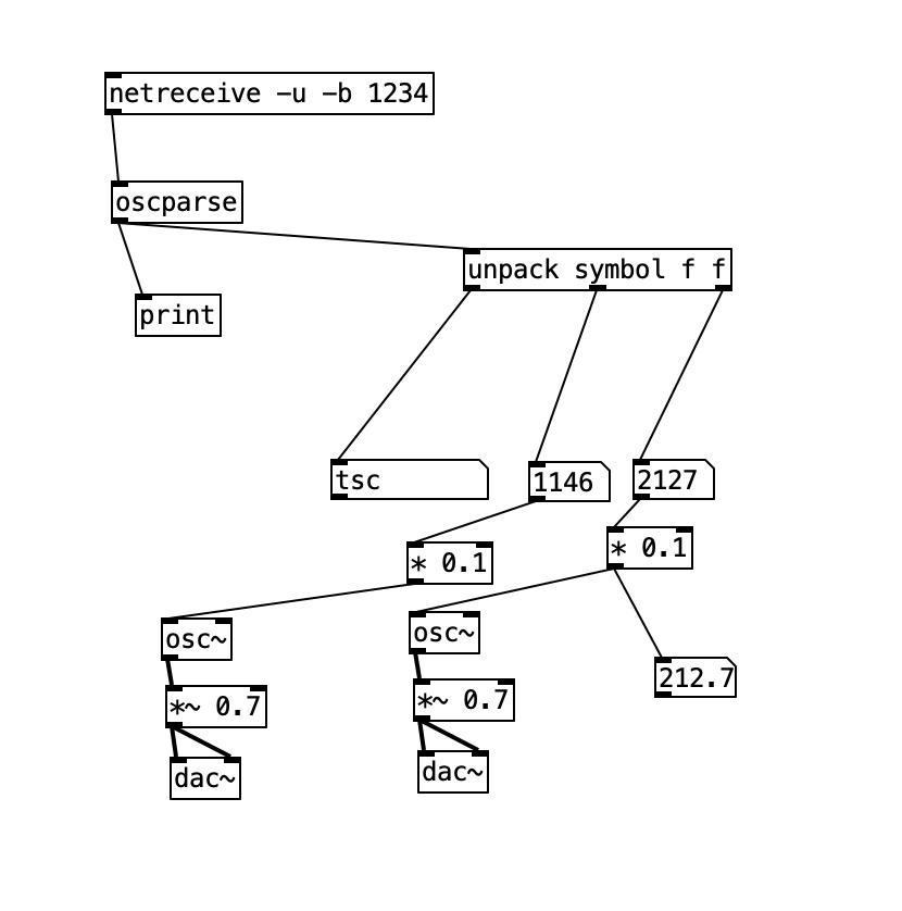

I struggle a bit to understand the log you posted, I assume that is a copy/paste of the console at the bottom of the Bela IDE, where there is a mix of messages printed from building/running/stopping the current program and the execution and output of commands you run in the console itself. Unfortunately, the project names are not printed, which makes things complicated for me to understand.
In one point you have this which would send to a Pd patch running on Bela:
Sending to localhost:1234
elsewhere you have:
Sending to 192.168.7.1:1234
which would send to the host.
