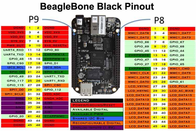

Ward Does the PWR_BUT also call cleanup() in render.cpp?

I am not sure how the shutdown procedure (which is probably called by both PWR button and Bela button) attempts to stop the running program (it probably offloads the task to systemd). As long as this sends a SIGTERM or SIGINT, cleanup() should be called and a graceful project exit takes place (there may be some timeouts after which the program is forcibly terminated).
