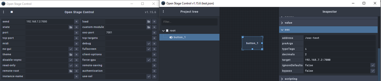

Hello, i'm currently working on a Project in which parameters have to be controlled over the PC (only for Prototyping later over an app -> so i can't use the Bela GUI). Does someone know how to set up the connection with OSC? On the PC i would like to use the Software "Open Stage Control". I modified the Osc-example so I could detect a message, but i'm not receiving anything.
Thanks in advance!

const char* remoteIp = "127.0.0.1"; //Probably use the Address from whatismyipaddress.com?
